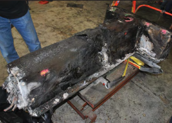

Two lithium ion batteries exploding due to overcharging. This isn't to show that lithium batteries are unsafe. I just got bored and decided to blow up a couple cells from an unused battery I had lying around by removing their circuit protection. Explosions are a lot of fun.
Hoffen wir das eine Schnellladung nicht so endet.
