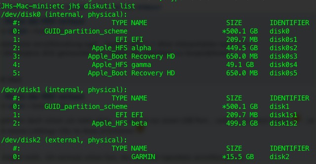

Sasch, mach doch mal: diskutil list
Evtl. hat die HDD mehrere Partitionen, dann brauchst du für dd den Identifier. Also z. B. dev/disk0s4.

Joachim hat geschrieben:Sasch, mach doch mal: diskutil list
gem8:
Code: Alles auswählen
enterprise:~ sasch$ cd Desktop/
enterprise:Desktop sasch$ mkdir ampera
enterprise:Desktop sasch$ cd ampera/
enterprise:ampera sasch$ diskutil umountDisk /dev/disk5
Unmount of all volumes on disk5 was successful
enterprise:ampera sasch$ sudo dd if=/dev/disk5 of=ampera.dd bs=512
dd: /dev/disk5: Resource busy
0+0 records in
0+0 records out
0 bytes transferred in 0.005181 secs (0 bytes/sec)
enterprise:ampera sasch$ diskutil list
/dev/disk0 (internal, physical):
   #:                       TYPE NAME                    SIZE       IDENTIFIER
   0:      GUID_partition_scheme                        *240.1 GB   disk0
   1:                        EFI EFI                     209.7 MB   disk0s1
   2:                 Apple_RAID                         239.7 GB   disk0s2
   3:                 Apple_Boot Boot OSX                134.2 MB   disk0s3
/dev/disk1 (internal, physical):
   0:      GUID_partition_scheme                        *240.1 GB   disk1
   1:                        EFI EFI                     209.7 MB   disk1s1
   2:                 Apple_RAID                         239.7 GB   disk1s2
   3:                 Apple_Boot Boot OSX                134.2 MB   disk1s3
/dev/disk2 (internal, physical):
   0:      GUID_partition_scheme                        *240.1 GB   disk2
   1:                        EFI EFI                     209.7 MB   disk2s1
   2:                 Apple_RAID                         239.7 GB   disk2s2
   3:                 Apple_Boot Boot OSX                134.2 MB   disk2s3
/dev/disk3 (internal, physical):
   0:      GUID_partition_scheme                        *240.1 GB   disk3
   1:                        EFI EFI                     209.7 MB   disk3s1
   2:                 Apple_RAID                         239.7 GB   disk3s2
   3:                 Apple_Boot Boot OSX                134.2 MB   disk3s3
/dev/disk4 (internal, virtual):
   0:                  Apple_HFS Festplatte             +958.9 GB   disk4
/dev/disk5 (external, physical):
   0:                                                   *100.0 GB   disk5
