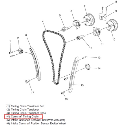

One other thing that has been quite controversial... Does anyone have any actual experience (=seen) of the timing belt? I've seen quite different opinions what kind of system the engine uses.
I've seen several suggestions of what it is (chain, v-ribbed belt...). Where can I actually see the correct information and at which point it is to be changed?
Service Manual Page 7000 (!):
Service manual: http://temp.paoberson.ch/AMPERISTE/Service_Manual.pdf
P.S.: V-ribbed belts are used to drive e.g. water pumps etc.
